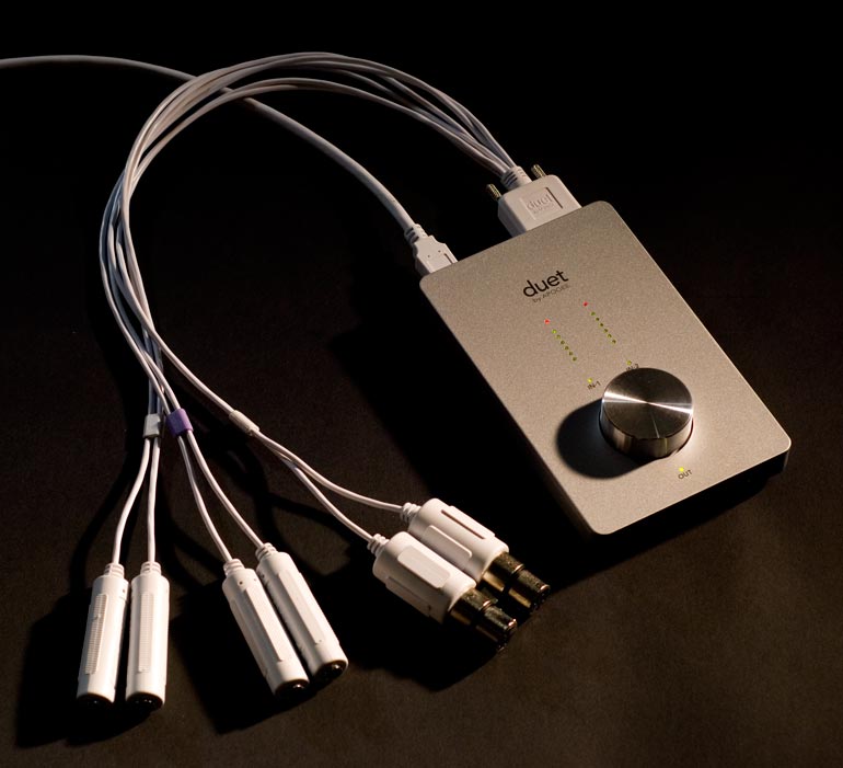

Evo ena nova zadeva:
http://www.apogeedig...oducts/duet.php
seveda samo za Mac-e rolleyes.gif ...
